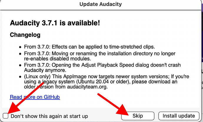

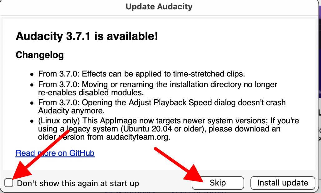

From what macOS to 15.2?
No. You get a message which informs you that a new version is available. You are always free to use an older version if that suits you better. You can skip the update, and you can even disable the update notice completely.

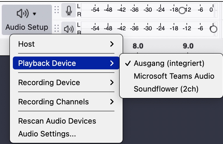

Did you tell Audacity where to output sound to?
What is Pro Tools Audio Bridge? Why not just select the Mac’s internal speakers? Or any speakers attached to the Mac via USB or via the sound-out connector?

I didn’t try to select the playback device because I have never had to, Audacity has always worked for me every time I updated over the years. I was diverted by the inputs offered to me by the Mac OS having updated the OS.
Pro Tools Audio Bridge is part of Pro Tools, another DAW that I have used.
I was trying to use Mac’s External Headphones, or Mac’s internal speakers, but they didn’t work because I hadn’t selected Audacity’s Playback Device which, I didn’t know existed.
Anyhow everything works well now, and again, many thanks.
Good to hear that it works now. :beers:
But I remember that this setting existed already ages ago in Audacity… no idea what was happening to your installation.
