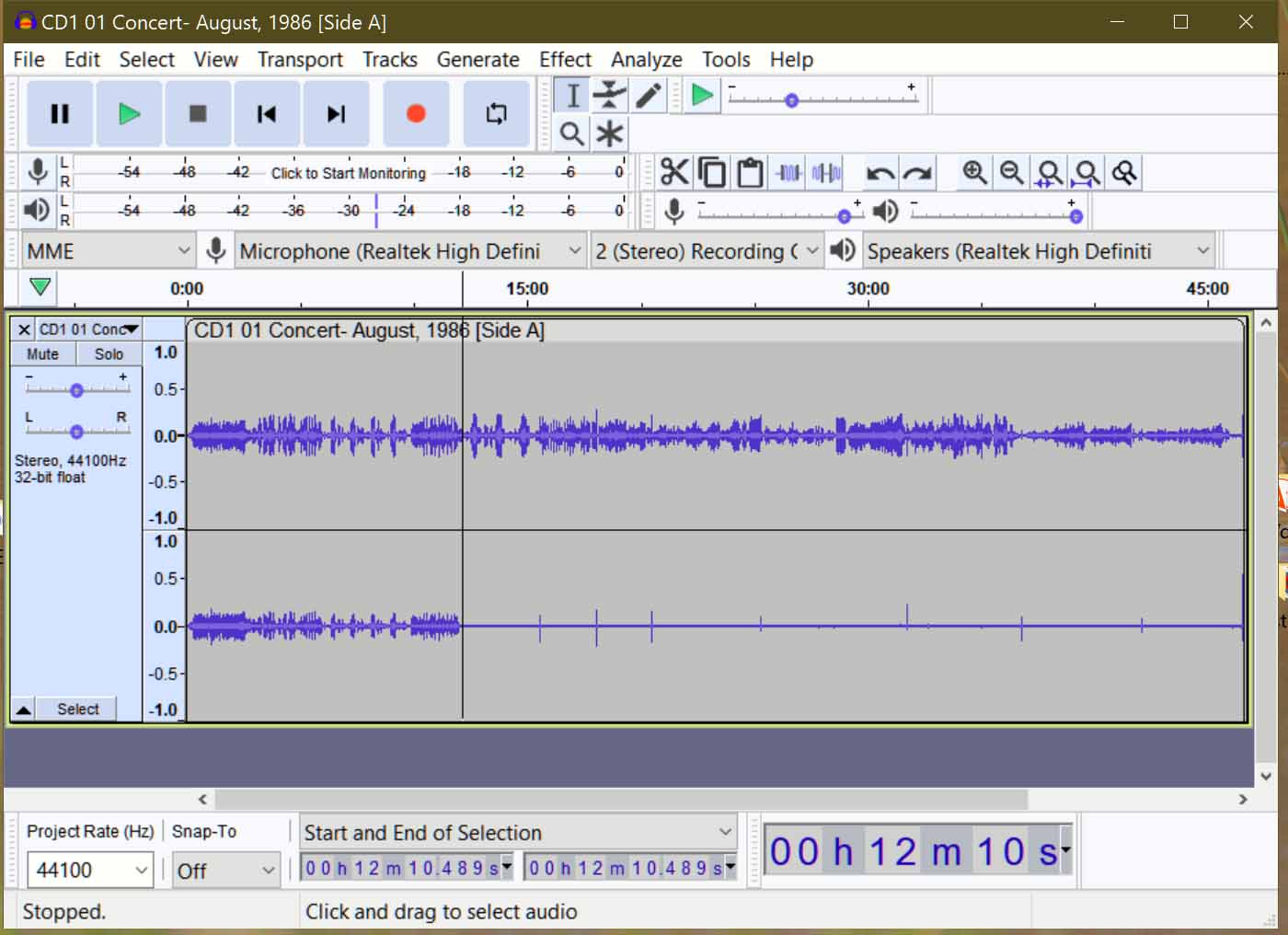

I have downloaded some old recordings that show up as stereo channels although they aren’t truly stereo, there’s different data on each channel and they don’t play as stereo.
The cursor proceeds to the end of the display so it looks like the second part that show up in the second channel doesn’t get played.
How can I make this whole recording into a mono channel and make sure all of it is played?

If I mix down to mono, the last 12 minutes of the concert, the lower channel, disappears and the whole thing stops at the end of the top channel.
No, there’s no sign that it’s “trying to be stereo”, the lower channel does not play.
It really should be one longer mono track, but shows as two simultaneous L/R tracks, except that the two tracks don’t play simultaneously. That is, I can only hear the top track in both sides of the earphones and nothing I do can switch to the lower track. Also, the cursor stops at the end of the visible tracks and play stops.
So you’re saying one channel is the first part of the concert and the other is 2nd part? That can be fixed by “splitting to mono” and shifting one of the tracks.
I have to log-off for an hour or so I can’t give you the details yet… And a true-mono file will play through both speakers so everything should be OK.
I assume those “blips” in the right channel noise that needs to be edited out?
Actually… It looks like right channel (bottom) is the same as the left in the beginning before it “dies”, except it’s a little lower in volume.
Try this:[u]Split to Mono[/u]. Now you have two mono tracks that you can edit separately and each track has a separate mute button.
Mute one channel at a time and if the bottom track is the same as the top except lower in volume and messed-up in the 2nd part, you can click the little “X” to delete the bad track, and you’re good to go.
If that’s not the situation, tell what’s going-on with each track and we can figure-out what to do.
OK! That worked, but there’s something odd now: when I paste the separated lower channel onto the upper, that very quiet section is at -35db where on the original lower channel it’s up to -15 or so and very noisy.
I can do some clean-up, but don’t understand why the volume and noise quality changed.
Thanks to you I’ve got a decently playable version of my old group’s concert from 40+ years ago. Too bad the recorder operator, me, screwed up the sound levels in places, but that’s what they paid for and I was worth every penny.
