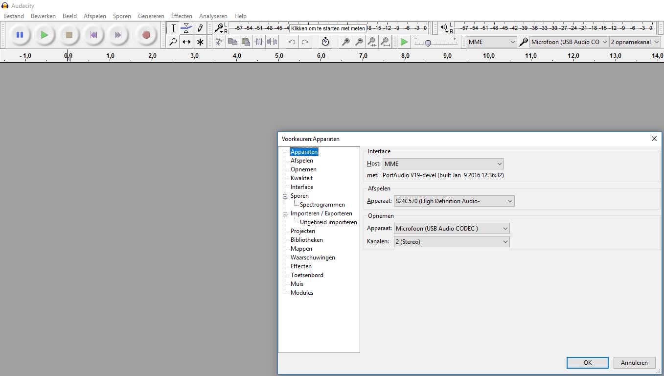

I received Audacity with my turntable Akai ATT05U. Same as NIKKEI NTT05U. On my previous OPS (Vista) I had no troubles recording via the USB cable and port on my PC.
Ever since I upgraded from Vista I can’t record via USB. I think it has something to do with the fact that when I select the recording device, I can only select ‘Microphone USB’. See images. I have a feeling it should be another device than ‘Microphone’. I tried deleting the Microphone USB Audio CODEC. But when I hook up the turntable via USB: there it is again…

Please describe the exact symptoms of that. Do you record a flat line? Or the blue waves are not tall enough? Or too tall (you record distortion)? Or you see error opening sound device? Or…?
Then the Microphone USB Audio CODEC is the correct name. Later Windows calls USB devices that use standard Microsoft USB Audio Class drivers as “microphones”. It isn’t the problem, but to help you with the problem we need to know the symptoms.

Regarding the recording, I do get blue waves. But left and right are identical/mono. Although the settings are set to 2 channels/stereo. As seen in the first image. Also the sound is too fast. And yes it is distorted. However, the waves are definitely not too tall/‘loud’.

That is probably fixable. By the system clock, right-click over the Speaker icon, choose Recording Devices then right-click over USB Audio Codec > “Properties”.
On the “Advanced” tab, in the “Default Format” section, make sure the dropdown menu is set to a “2 channel” choice.
If you are still getting a too fast recording, try “2 channel 16-bit 44100 Hz” and set Audacity project rate (bottom left) to 44100 Hz.
You can try both Default Format and Audacity Project Rate at 48000 Hz too, and you can try enabling / disabling the two “Exclusive Mode” boxes underneath where you change Default Format.

Now, what was the solution? Out of frustration I tried the other USB connector in the front: error! Then the one on the back of the PC. Bingo! Recording is in stereo and clear. Also the description of the hardware is different. When connected to the front it says Microphone USB Audio CODEC. When connected to the back it says Microphone 2 USB Audio CODEC.
