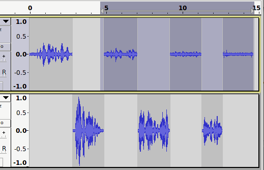

There is an alternative approach that can be used in Audacity, which is to separate the regions across 2 (or more) tracks like this:
Yes I understand that approach. I did pursue that method but haven’t been able to get my clip selections in one other track. Every time I make another selection and try to “Split New” it puts it in another totally new track. I can’t figure out how to get a batch of clips into one other track by Split New or Time Shift Drag. The Time Shift Drag screws up the timing from track to track.
Yes it’s a bit tricky.
The easiest way that I’ve found is:
- Create “Splits” between the sections (Ctrl + I or “Edit > Clip Boundaries > Split”)
- Duplicate the entire track (select the track then Ctrl+D (or “Edit > Duplicate”)
- double click in one of the sections and press Ctrl+Alt+K to delete that section without moving the remaining audio (or “Edit > Remove Audio > Split Delete”)
Repeat step 3 to remove alternate sections from each track.
