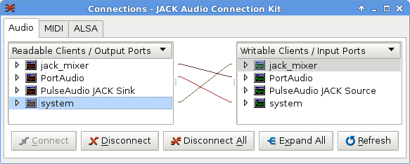

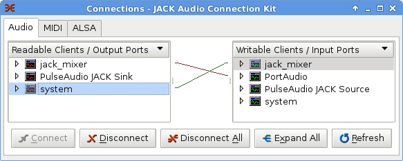

Ideally, we would just connect Input 7 of the sound card to Input 1 of Audacity, and Input 8 of the sound card to Input 2 of Audacity, then just leave it like that.
Unfortunately, that does not work because Audacity creates new input and output ports when it needs them, then closes the ports “on stop”, and each time it creates ports, they are numbered differently. This is why we use a “dummy” device between the sound card and Audacity. The dummy device can be any Jack application that has at least 2 inputs and 2 outputs that can be set to do nothing. I used to use an instance of “Jack Rack” with no effects in it, but now I use “Jack Mixer” (which allows me to control the audio input level in real time).
So with Jack Mixer launched:
  • In Audacity, “Transport menu > Rescan Audio device” (If necessary) so that Audacity can see Jack mixer. (Audacity only looks for available ports when Audacity is launched, so if you add Jack Mixer after Audacity you will need to “rescan”).
  • Add a stereo channel to Jack Mixer and name it “PreSonus 7 8” (or anything you like)
  • Connect the input of jack Mixer to inputs 7 and 8 of your sound card to “PreSonus 7 8” of Jack Mixer
  • Using the device toolbar in Audacity, select “Jack Mixer” as the recording input, and “system” as the output. Audacity will now automatically connect to the mixer when you start recording.
If you are using QJackCtl, you will see Audacity automatically connect to the mixer if you look in the “Connect” window.
When recording:
and like this when overdubbing:
