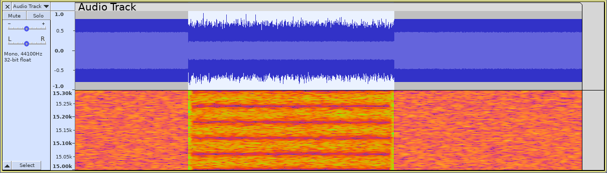

and the result when applied to white noise:
If we use a very much higher “q”, and zoom in on the high frequency range (using the maximum window size in Spectrogram settings), we can see that the code is working correctly:
(setq a 60)
(loop
  (setq *track* (notch2 *track* a 80.0))
  (setq a (+ a 60))
  (when (> a 20000)
    (return *track*)))
