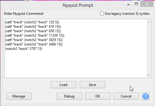

It looks like mains hum,
notching out the worst offenders helps, (but notches cause collateral damage to speech).
Newfangled AI does a better job, as the hum slowly changes timbre.
[original - Audacity notched - Izotope de-hum plugin ]

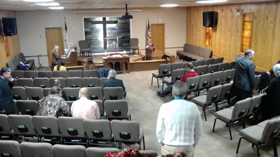

The room doesn’t have stage lights, but there are can lights and some old fluorescent tube lights. One set of these lights flickers and suddenly changes brightness.
Most of the microphones used are wireless, but in this case, the speaker is using a wireless lapel mic. I can find out the make and model if that helps.

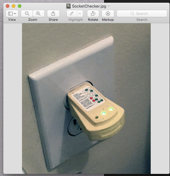

In general, a two or four outlet wall panel has everything connected to the same place. So any of those sockets should do.
Nobody wrote that the sockets have to be wired correctly. Both houses I lived in had electrical wiring errors.
You can get a simple and cheap socket tester.
I see people trying to sell computerized, steam driven, hot and cold running beer socket testers. Thanks, no. Three lights will do it.

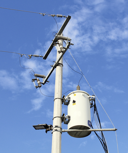

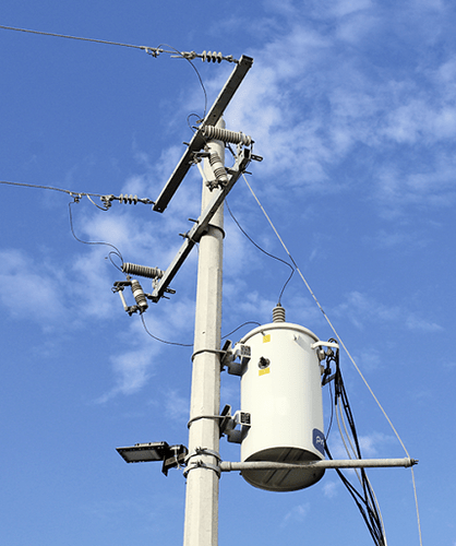

Just to be crystal clear about this. The shield or case of your electronics is connected to the third prong on the electrical plug. The round one in the US. Ideally that goes to a metal stake shoved into the ground outside the building.
If you have a wiring error, your protective electronic shields (and the case on the mixer) could be connected to that power transformer on the service pole.

I have a Hyper Tough (Walmart brand) socket tester kit…
