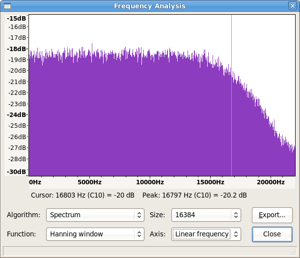

Here we can see that during the conversion a low pass filter is used to remove frequencies close to the nyquist frequency which would otherwise cause problems.

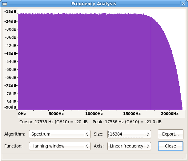

Now with the Secret Rabbit Code (libsamplerate):
Here we can see that the high frequency roll off starts a bit earlier, but the attenuation at the nyquist frequency is very much lower than with libresample. It is so much lower in fact that it is running into the dither noise, so here it is again with dither set to rectangular instead of shaped:
Now we see that the level close to the nyquist frequency has dropped below -90dB (virtually nothing).
