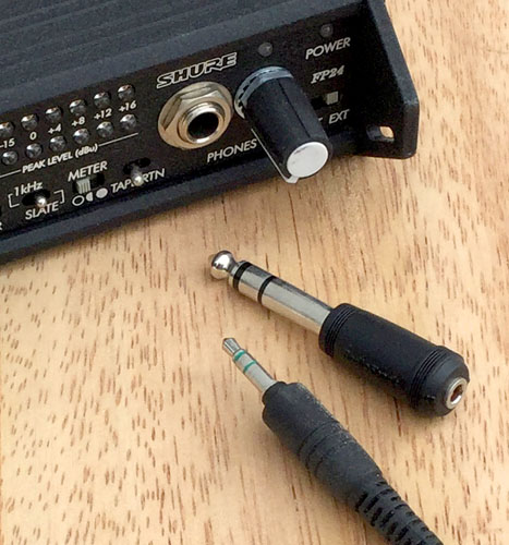

You should still proceed with your headphone connections. Like this, right?
My field sound mixer has the same connection problem.
In the US, that would be a 1/4" Male Stereo to 1/8" Female Stereo. Everywhere else, it’s going to be 6.5mm Stereo to 3.5mm Stereo adapter.
