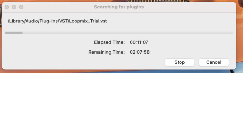

I’ve been using 3.2.0 for a Mac since it came out but today the scan for plugins is up to 104 minutes and still increasing. It was working fine yesterday. If I cancel or stop the process only one of my VST3 effects shows up in the track control panel. I’m running Audacity 3.2.0_X86 on a MacBook Pro M1, 32GB MacOS 12.6.
If I cancel or stop the process all but one of my VST3 effects shows up in the track control panel.

If the file name shown in that window (in your case: “/Library/Audio/Plug-Ins/VST/WaveShell1-VST 12.7.vst”) displays for more than a few seconds without changing, then Audacity’s plug-in scan has become stuck and you will need to click the “Cancel” button.
Sometimes this issue will clear itself if you reboot the computer and try launching Audacity again.
If the problem does not clear itself, then you may need to remove the plug-in that is causing the problem.
Unfortunately it can be a bit tricky working out exactly which plug-in is causing the problem. It could be the plug-in that is displayed in the message (“WaveShell1-VST 12.7.vst”), or that one may have loaded successfully and it may be the next plug-in that is causing the problem.

I have the same problem with the same pluggin. Waves isnt my favorite anyway. Ill see what happens when I eliminate that problem, but I have included a screen shot of 5 instances of Audacity. MacOS 12.6 MacPro MacBookPro for your amusement. This thread has been helpful.
