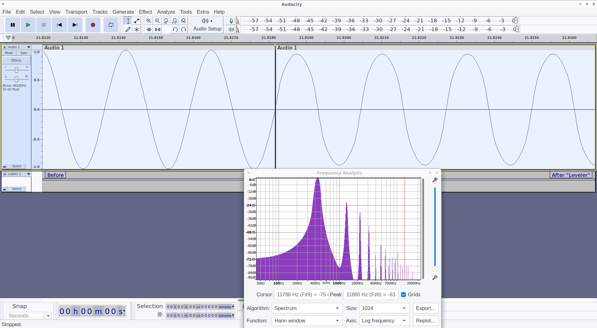

But it IS a distortion effect.
The version of “Leveller” in the Distortion effect uses the exact same algorithm as the original distortion effect, and it is a “waveshaper”.

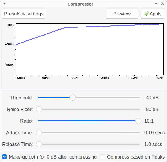

If the sounds don’t change too rapidly, Audacity’s “Compressor” effect can do that sort of thing, though the sounds that were originally LOUD will still be a bit louder than those that were originally quiet.
You will probably want settings similar to this, but do experiment with the Threshold setting for best results:
I sort-of assumed all of the “distortion” effects were based on the same algorithm(s) but it’s not supposed to sound like distortion and if you feed-in a sine wave, hopefully you get a sine wave out.
That’s true for Audacity’s Distortion effect.
Audacity’s Distortion effect is technically a “waveshaper” effect. It acts directly on the waveform, modifying the shape according to a selected formula. “Loudness” implements one formula, whereas “Hard Clipping” implements another, and so on.

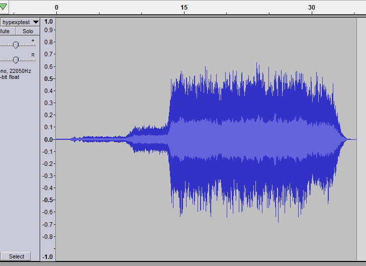

It may be that Audacity’s built-in compressor effect is not ideal for your purpose, but there are other compressors available that have different characteristics. For example, the “Level Speech” Nyquist plug-in (available from this page: Dynamics Processing - Audacity Plugins) copes very well with very large variations in the loudness. There is also the “Pop Mute” effect (available on the same page) that is great for reducing the level of sudden loud sounds.
Yes, checked. Thank you. Downloaded the file, “LevelSpeech.ny”, but I am not sure how to install it. Or whether it will serve the purpose. In case it doesn’t how could I remove it cleanly?
Thank you, Mr. Trebor, for the information.
Yes, Mr. Trebor, It indeed looks brutal. As a novice I thought I needed the other file, “LevelSpeech.ny”, but it seems I would indeed need the file, “hyperexp.ny”.
