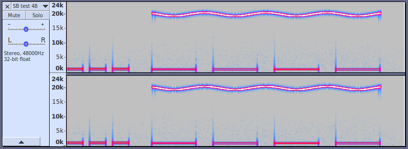

Could you post the actual test file that you are using, I’d like to try it on my machine to see what happens.
It’s in first post SB test 48.wav
But you probably will not hear any distortion, even if there is resampling(s) because of high quality of resampling in modern sound cards.
I suggested in this post test with RMAA to find out actually playing sample rate and level of distortion. To do this, you need 2 PC, one of them with Windows.
When you import it into Audacity, does it look like this:
and the track spectrogram view like this:
The point is to play in 48 kHz sample rate a tone of 23-24 kHz (>44.1/2…<48/2) and record. If there is 48>44.1 resampling, there will be no frequencies in the recorded signal above 22 kHz (44.1/2). You can run RMAA in Wine and record a digital loopback. It’s not very reliable though. You can play and record digital loopback directly in Audacity I suppose. RMAA can generate a test WAV file. Tomorrow, I delete Linux and return to Windows. If you still have tests, hurry up.
