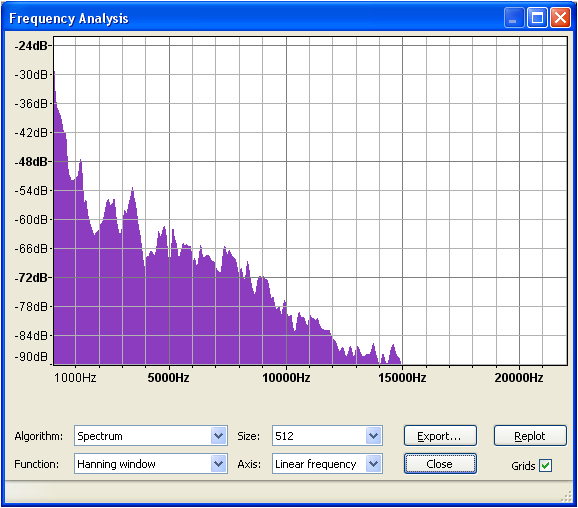

I analyzed the spectra of the various recordings and attached a picture. The wav file and iTunes show a fairly linear drop in signal with increasing frequency and then it stops. Both the Audacity compressions show a precipitous drop to -140 dB. The fall off gets increased with the 40kbps but is still there.
Could this be the source of the ringing?

-140db is silent, you’re trying to remove something that can’t be heard: the threshold of audibility is about -100db.

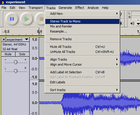

Trebor’s guidance on converting to mono before converting solved the ringing problem and should allow us to get adequate sound quality for the lectures in a compact format.

Here’s some spectral output from the various recordings for a noisy period at 0.2-0.4 sec. The 16000 Hz mp3 conversion of the stereo file shows more spikes which could indicate the ringing. The mono file, suggested by Trebor, shows less structure and is listenable, at least for lecture notes. A signal processing guru colleague suggested the stereo mp3 spikes could have resulted from the channels stored as L+R and L-R. Or is there another explanation?
If combining the stereo tracks to mono in audacity is creating a ringing effect, (possibly a comb effect if one mic is further from the lecturer than the other),
then instead of combining the stereo tracks (L+R) to produce a mono one, just discard either L or R track and make the remaining one mono.
e.g. use “split stereo to mono” on your original stereo track then discard one of the two mono tracks produced. If one track is inferior, (quieter or noisier), then bin that one, otherwise delete either one. Clicking on the [x] on the top left corner of a track deletes it, (this deletion is reversible using “ctrl” +“z”).
