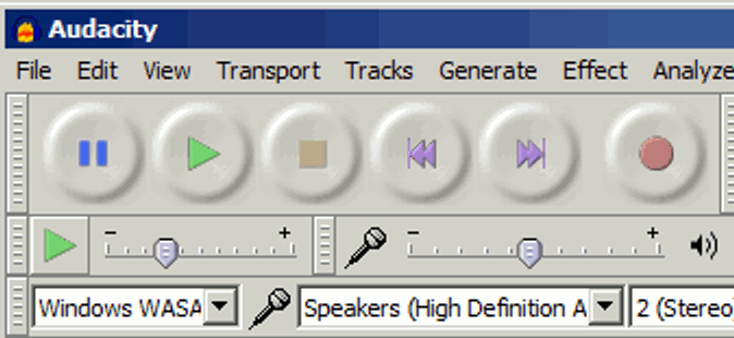

Just press the on-screen stop button, (the orange square).

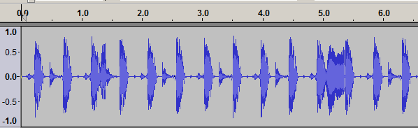

You must make sure you don’t press the CTRL key when you click in the blue waves.
Normal playback (press the SPACE bar) is always forwards (left to right).
Effect > Reverse used once makes the blue waveform start at what was the end of the audio, like as if you looked at the waveform in a mirror. Normal playback then sounds as if it is playing reversed.
Use Effect > Reverse again to undo the first reverse.
