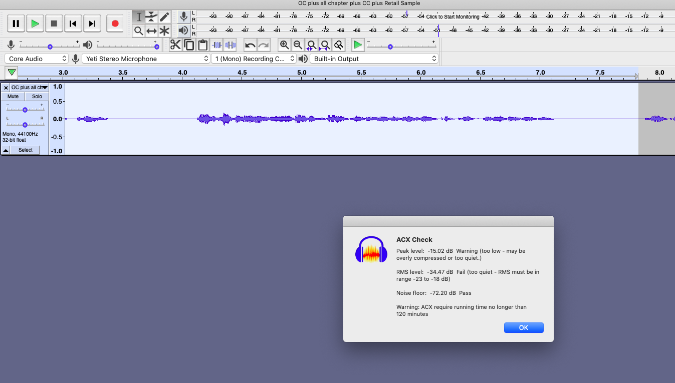

  1. a WAV files cut from my overall master WAV file - it has a few seconds of room tone, followed by initial narration. when i run the ACX check on this section, it actually passes noise floor but fails peaks and RMS.
  2. ive attached a screenshot of the ACX check for this short section
  3. i have also attached a screenshot of the ACX check for the entire 3 hour 10 min WAV file

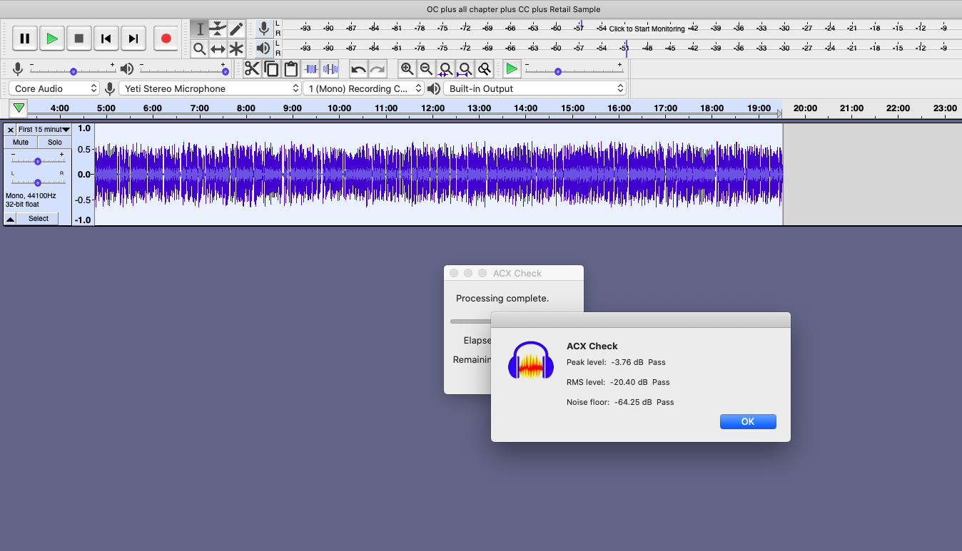

btw, also attaching a screeenshot of ACX check of the MP3 of the first 15 mins after i ran the 3 effects i noted - you see even this passed. so something occurred between this time and completion of rest of file that made the noise floor fail

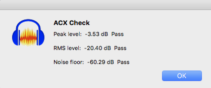

I mastered it and it did pass ACX Check, but noise did it by fractions of dB not the recommended 5dB. -60.29dB, not -65dB.

Right out of the instructions in the wiki. When I got done, I ran Analyze > ACX Check.
I didn’t do anything magic and technically, that does pass.
