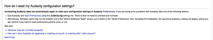

Hence, I would like to just reset everything and hopefully get back the default settings. In this case, I’m trying to avoid doing a complete re-install.
The easiest way to reset Audacity on Windows, is to re-run the installer and select the option to “Reset Preferences” during the installation.
The installer is available here if you no longer have a copy: http://www.audacityteam.org/download/

Making the change in the audacity.cfg file was what I needed to get the other channel back. As the recording I’m doing is voice-over type work, I had set to record Mono, but Audacity thereafter dropped the Right channel. The “RecordChannels=2” setting in the cfg file brought back the right channel. In the end, when exporting my recorded file, I can force it to mono, which is what matters in the end.
