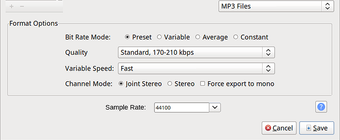

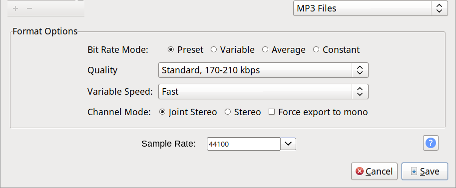

I wonder if there is any way the software could help clarify exactly what is going on ![]()
