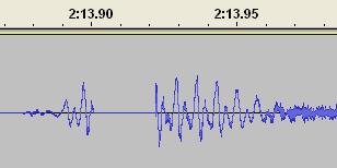

I’ve got an MP3 recording that has numerous dropouts, as seen below.
Dead silence for about 0.021 secs.
This is too long to use the “repair” effect.
Is there any way to either smooth them over or just delete them?
There are longer stretches of intentional silence. But I think just targeting silences of this length or less might work.
If I delete the silence and then select the join and do “repair”, I get a tolerable result.
But there are too many to do them all manually.

That won’t work. Even if I select the region containing a dropout, it’s too short to trigger it. Anyway, this is a spoken word track and the space between words is silent (dead silent, presumably by design) so there are thousands of “correct” silences.
