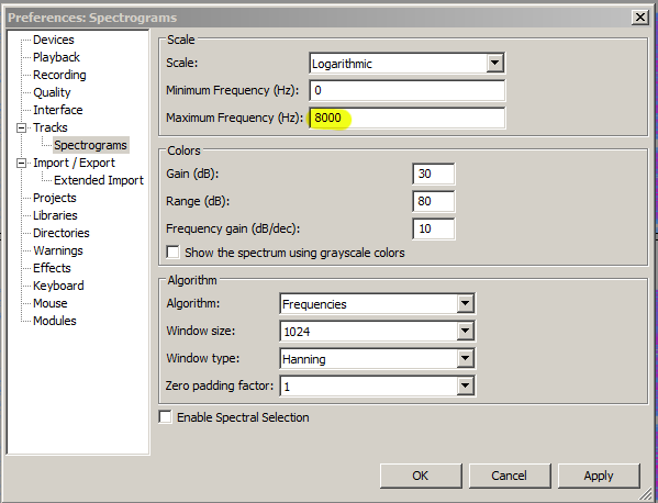

Those noises have highest energy at about 10kHz , you may have to zoom-out on the spectrogram to see above 8kHz,
also achievable by increasing the maximum frequency of the spectrogram display in Audacity preferences …

Ah thanks. I actually didn’t notice it wasn’t showing the entire frequency range.
Though I believe the person I was recording simply built up a lot of saliva in their mouth and it caused those sounds and I didn’t pick it up during recording. The microphone is less than a month old, so I highly suspect it something is up with the diaphragm. But I’ll keep it in mind in case this happens in the future with other sounds.
I just tried and it was easier to notice them as they did spike a little bit above on spectrogram, and I could just remove them (or at least one I spotted right after reading this. There are still a few with lower frequencies). Thanks!
