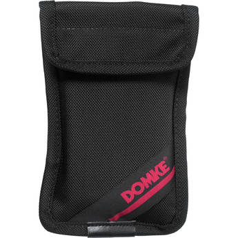

Lead lined pouch ? ( designed to block x-rays) …
http://www.bhphotovideo.com/c/product/218287-REG/Domke_711_11B_Film_Guard_Bag_Mini.html#features
The lead compound used may not actually conduct electricity so I’m not sure if it will work to shield against RF.

It may have the same effect but different technologies. Instead of suggesting strongly that radio waves go 'round (Faraday cage effect), lead absorbs them and turns them into heat. There is no doubt in my mind it would work. It doesn’t look like you raided the pantry, but you may have to figure out where to put the microphone.
