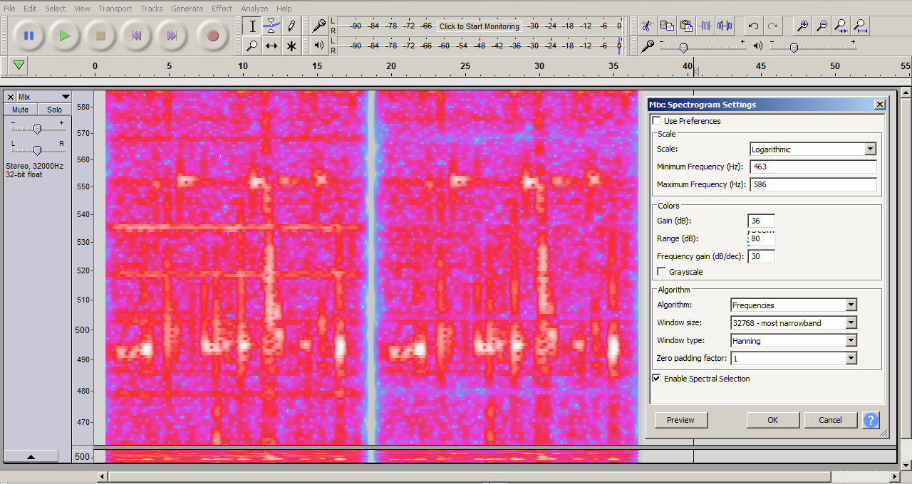

I did figure out how to get the spectralgram and yes, I have it in full screen, but after that I can not follow your video you made for me, as its is so small to see and so fast. I am using my original Audio track, of 29 minutes, as I do see a white area at the bottom of each track, as I am not sure that is the fan noise? Again, you have gone out of our way to help me. Mike
I have figure out how to get the blue line, as I assume this is the fan noise? But I do not know how to delete it. My Audacity program looks a little different from the demo you have kindly sent. My version is 2.1.3
You need to change the numbers of “Gain”, “Range” & “Frequency gain” in the “Colors” part of the spectrogram-settings to this …
The fan-noise consists of at least ten (horizontal) lines which are constant throughout the recording.
The right side of the picture above shows the “after” where I have notched-out five of them, around 480Hz -570Hz.
There are more noise lines : the give-away sign is they’re unbroken …
Delete it using “Effect > Spectral edit multi tool”, which is a notch-filter.
