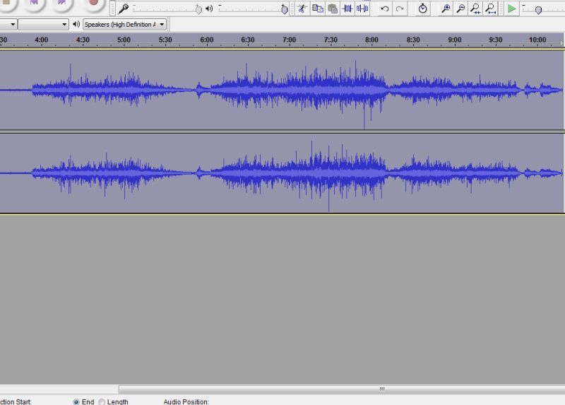

New to this forum, but anyhow, last year, I recorded a file which has pretty bad clipping in it. It’s not that bad in which one can’t hear any of it clearly at all, but it’s certainly not clear of clipping. I was just wondering, are there any tools in Audacity that can eliminate this clipping? I’ve tried the de-clip plugin, and I can’t seem to get it to work properly. Basically it I just waiting for the process to end, and it’s exactly the same afterwards. Basically, I just want to replace the faulty bits with stable ones, but I’d like to do it using a in a program, instead of a long daunting task doing it manually.
I’m using version 2.1.0 btw. Windows 7 Home Premium 64 bit
Here’s a preview of the bad file. I really want to get this one fixed if possible, as the actual audio its self stands out to me like dogballs. It’s been annoying me for months now, but I recorded it with the wrong settings unknowingly.
http://i7.photobucket.com/albums/y255/SAR704/0805cprev_zps2ncs8suu.jpg
Thanks
That waveform doesn’t look clipped. At least not badly… There are couple of negative spikes, but at that zoom level it’s hard to know if there’s some kind of glitch, or clipping, etc. And in general, you can’t judge sound quality by looking at the waveform…

If you select View → Show Clipping you should see red where there’s clipping, and if you zoom-in you should see [u]clipped[/u] waveforms. (You might have to use the Amplify effect to reduce the volume in order to see the clipped peaks.)
Note that MP3 compression often boosts some peaks by one or two dB . MP3 files can to over 0dB, and this peak-boost can result in Audacity showing potential clipping even though the wave peaks are not clipped.
