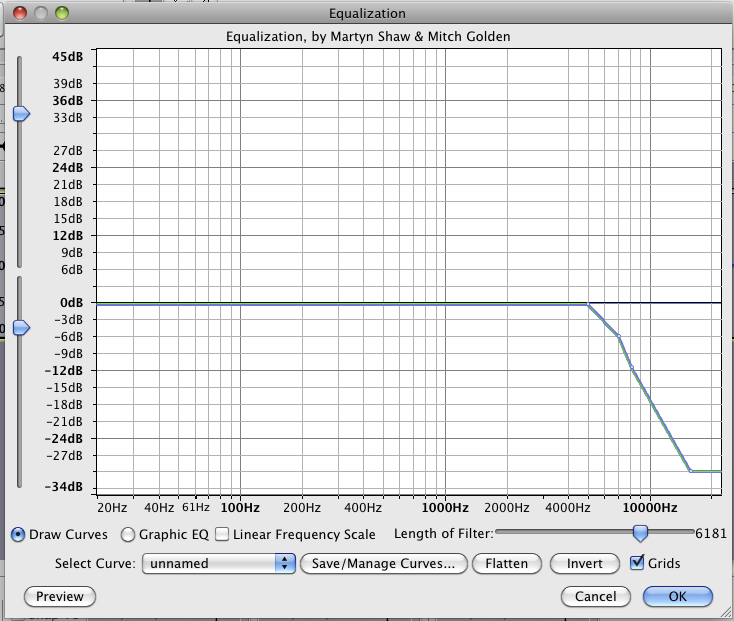

Try applying the attached equalization curve to “dull it down” a little (click on the graphic). Each of those little dots is a control point which you get by clicking and dragging. If it’s too much dulling, UNDO, move all the points to the right one graph line and try it again.

How do I deal with the crispness? I tried the equalization pattern with the 6181 setting and to my hear it made no difference. I can send two samples before and after if you wish.

So I guess my questions for now are: 1) if the 6181 Treble Cut didn’t work, are there other settings I should try or, 2) since you guys said originally there really wasn’t anything wrong, such I just work on my elocution? 3) is the crispness the cause for the S’s or are you just hearing something wrong in general with the recording?
