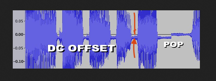

It’s only effective before editing. Remove DC doesn’t go down the show syllable by syllable adjusting the waves. It takes the whole show’s waves gently up or down until that little space on the left between sound silence and “0” timeline goes away.
This, badly illustrated, is the offset. That downward positioning of the waves. Silence is supposed to settle at 0.00 on the timeline. The stuff on the left doesn’t.
The sound on the right never had any space there, so it’s normal.
None of this has anything to do with the tips of the waves. The quality of the voice or instrument determines that, and no, they don’t have to match at all. If you start worrying about the fuzzy quality of the blue waveforms, it’s going to be a very long day.
