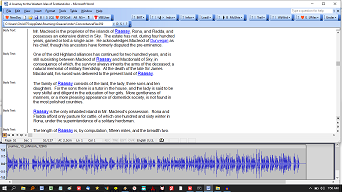

Here I am, editing a chunk of an audio book over 60 minutes in length.
I recorded the book from a text copy, which is why we see text at the top of the screen, and I perform a “raw edit” by playing back the track while reading the screen.
In the track all I need to see are the spikes where I clapped my hands to signal a “known error”, and the gaps which must be reduced by macro to either a Sentence gap or a Paragraph gap.
For anything between two and three hours I will sit here, applying mouse and keyboard shortcuts to the track.
I do not need anything other than the waveform; the area circled in purple I could do without for this period.
The more text I can have displayed on my screen, the less time I spend in interruptions to:-
(1) Alt-tab to MSWord
(2) Scroll the text further up the screen and
(3) Alt-tab back to Audacity.
This is not a critical issue, rather, I don’t want to feel stupid at the end of the project when I learn that I could have worked more smoothly for these two months.
Thanks for any tips, instructions, or even a flat “It can’t be done”, which would stop me fretting about it (grin)
Chris

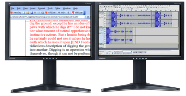

How about using 2 monitors?
This way you can have Word on the one with all menus, etc.
and Audacity on the other.
Prices have come down as everyone wants the newer super duper, ultra 4K, ultra wide, ultra
quick refresh rate for gaming screens.
You just need an extra plain vanilla 21" monitor.
Your laptop’s screen can act as one of the monitors.
If you place the extra monitor on a stand or even a box, you can then have the laptop
below it.
I’m 99.999% sure that your laptop will have either a VGA or HDMI output.
This, will make it neat and compact and give you loads of screen “real estate”.

  1. I am a fan of Alt-Tab to switch between two Windows screens instantaneously, although I don’t know if that will work for you.
  2. What Paul2 said.
  3. One of the developers has had it in his head to have a fisheye display of the audio track. He has been working on this for quite a while (5 years?), but you never know when his idea might come to fruition. :smiley:

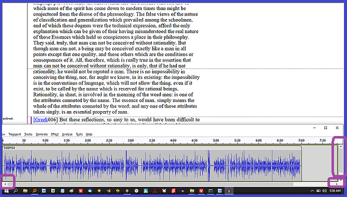

Hi jademan; yes, as outlined above, I am using Alt-tab on a single laptop to do the Raw-Editing (I think that a professional would do "post-production editing, or something similar with lots of big words). That works fine for me.
Yesterday I learned the names of all the Audacity toolbars (grin) and found that I saved practically no space at all. How can this be?
If I had thought about this before posting:-
(a) I have one mono-track which means I can squeeze the vertical height of the Audacity window down so that it shows just the waveform; the Windows pane scrollbar at the foot of the Audacity Window lets me fast-scroll along the track and
(b) With the Document Window squeezed correctly, that occupies the laptop screen except for that waveform segment at the foot of the screen. The Audacity toolbars above the waveform are always hidden by by the overlapping document window.
The image above shows the setup in Audacity with its full complement of toolbars, none of which can be seen.
This just proves that I am never quite as clever as i think I am.

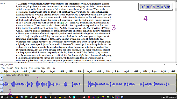

And here is an update - my best (for me!) layout so far when I am in raw-edit mode of proofing spoken text read from a document.
(1) I have the wave form visible to me; I can “look ahead” and spot sentence and paragraph gaps arriving, also my hand-claps which signal a need to carve out a serious chunk of badly spoken text.
(2) I have the scroll-bar visible so that I can scoot to left or right by one visible chunk of waveform.
(3) My document text is in full-screen mode and
(4) The clock is floating and visible, for those times when I need to Alt-Tab into a control document and type in the start/end mm:ss of Greek text, footnotes, parts and other stuff.
