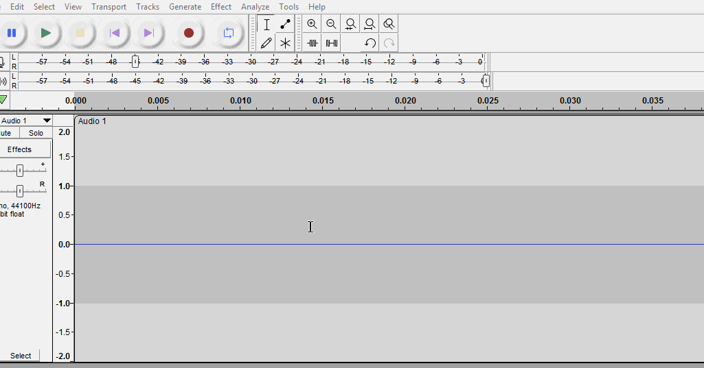

Hi Steve, Thank You so Much, where do i paste this?
Nyquist Prompt …
generate
NB: have to generate some audio for Nyquist code to work on, e.g. silence.
In most versions of Audacity you will need a “selected region”, but it can be empty (no need for any actual audio in the selected region).
(Logically it should work without a selection because the code is running as a “generate” type plug-in, but I’m not sure that has ever worked in the Nyquist Prompt - it hasn’t worked for a long time if ever.)
