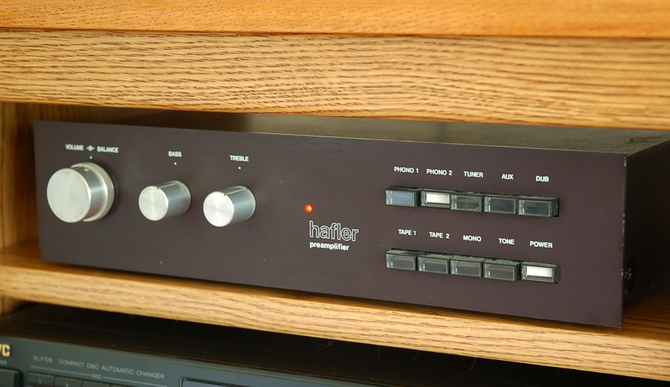

I did it with a Hafler music system preamp (with volume control) and either the UCA-202 or the Line-In of a Mac.
Hey! An original David Hafler designed preamp. Been a while since I saw one of those!
