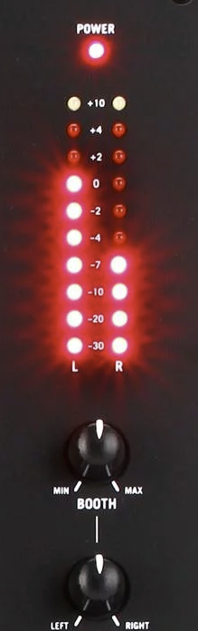

Something’s broken. When you did the Windows test, did you have the Numark master sound meters up to at least zero and maybe higher?
