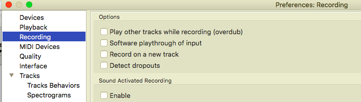

Is this what you want? These are the preferences.

“Preferences > Recording → Record on a new track” - is that ticked or not ticked?
It’s only one input coming from my interface, so I had created a mono track for it. The click track is also mono. “Record on a new track” was not ticket because I wanted to add the recording to the end of my current track, it’s just that no matter whether there’s nothing on my currently selected track, once the record button is pressed, it “fills” up the track and the sound starts filling the end of the click track.
