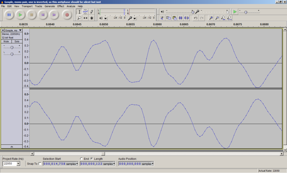

However when I tried this with a gospel track, attached, there no cancellation, no silence, the music was full volume.
(NB: the gospel track was originally 41000 resampled to 22050, I think here lies the problem).
Gosple, mono pair, one is inverted, so this antiphase pair should be silent but isnt.png

No it shouldn’t be silent unless you are monitoring in mono. You should have “anti-phase” audio from left/right speakers if monitoring in stereo.
If you do steps 1 to 4, then that should (and does in my tests) produce silence (or near silence for 16 bit audio)
With the Gospel track, if you use “Split to Mono”, then you will get the expected silence.
Ahh now I get it:
antiphase stereo is full volume (just sounds slightly different from regular stereo)
antiphase dual mono is silent.
My mistake. Thanks Steve.
