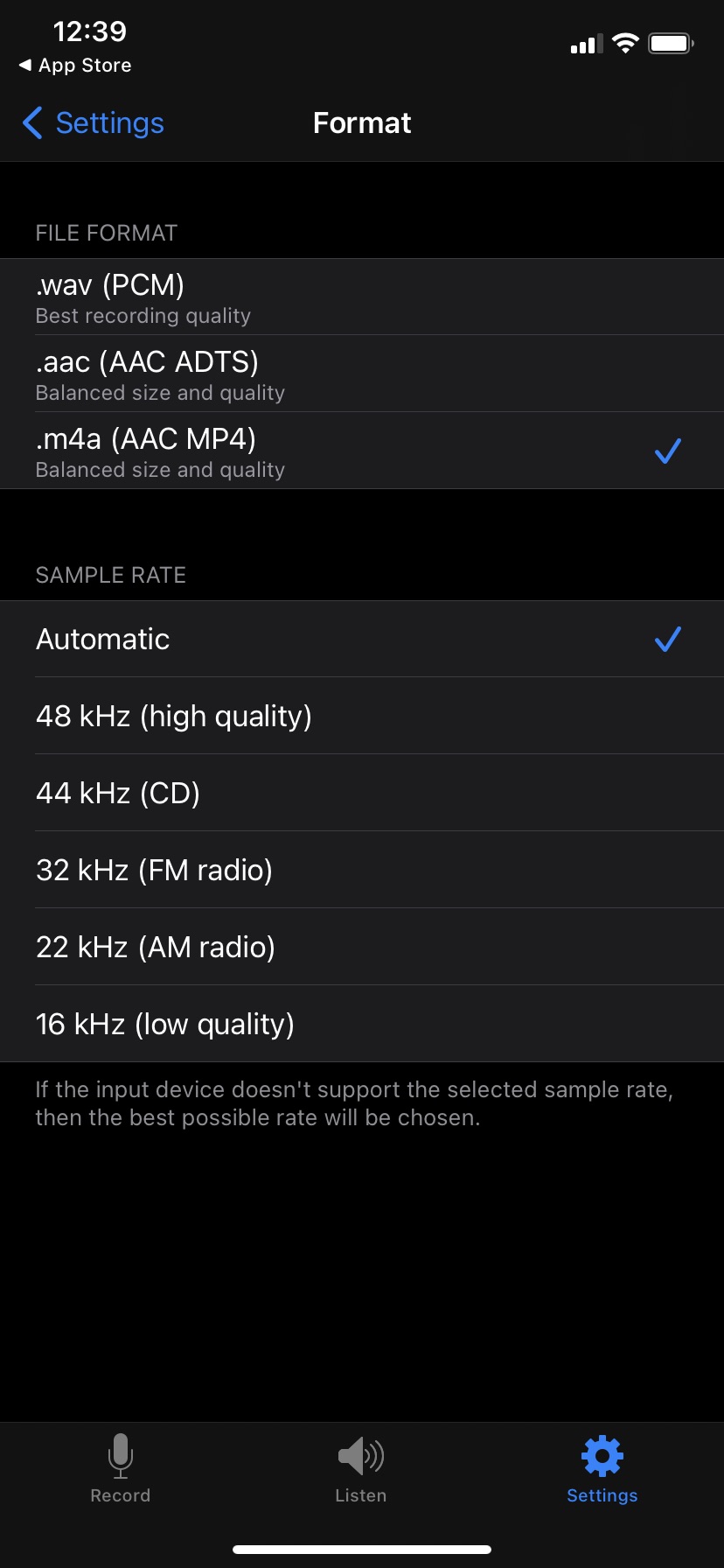

sample rate is configured automatic in Easy recording app.
change sample rate to 44 kHz should work
