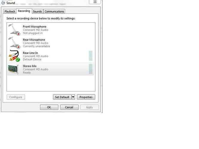

None of them, unless that “Rear Microphone” means the blue Line-In which I doubt.
Right-click over the speaker icon by the system clock, then choose “Recording Devices”. Right-click in empty space and choose “Show Disconnected Devices” then right-click again and choose “Show Disabled Devices”. Assuming “Line-In” now appears, right-click over it and choose “Enable”.

Shrilurk: I was referring to the audacity preferences for recording device. A choice has to be made, so not sure how it can be none?
Also see attached image of recording device choices.
I’m marking this as [SOLVED] assuming your update means that having shown and enabled "Rear Line In " in Windows “Sound”, you can now choose that input in Audacity Device Toolbar.
