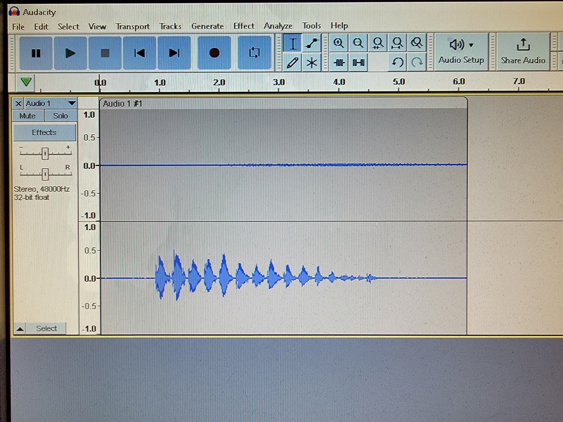

I recently plugged a Shure SM58 mic in to MIC/HI-Z jack 2 on my Steinberg UR44 USB audio interface. I can hear audio in stereo through the computer speakers plugged in to the Phones 1 jack on the UR44 (not recording), but sound is recording only on the right channel, and playback only on the right speaker. Attached image 1

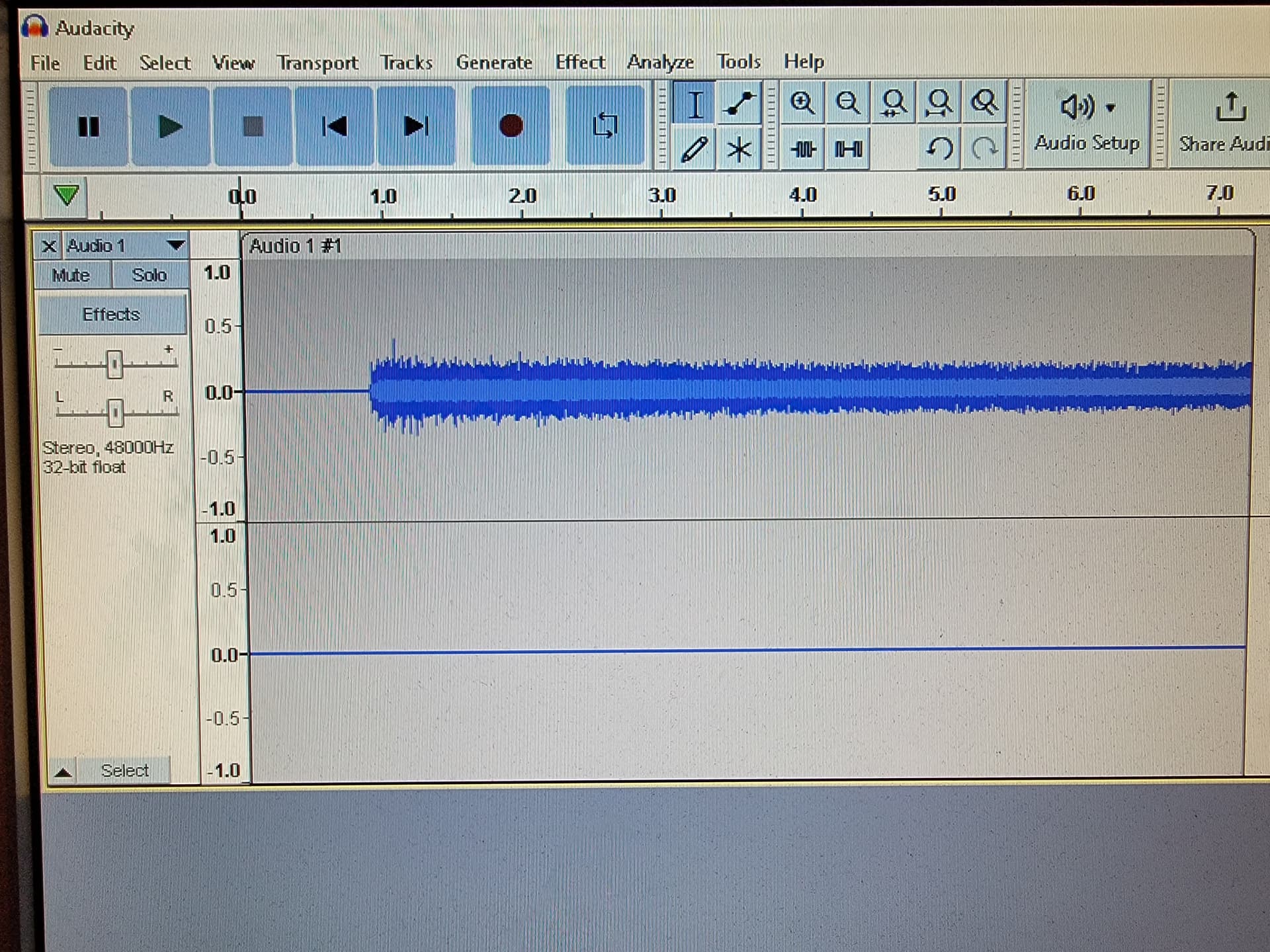

Then I discovered my guitar recording (plugged in to MIC/HI-Z jack 1) is now left channel only, playback on left speaker only (Attached image 2)- before I plugged the mic in, the guitar recorded on both channels and playback was in stereo, so my guess is something has changed, but I don’t know what. The guitar audio is still coming through the speakers in stereo (not recording).

A single microphone (1) or a single instrument is mono. Vocals are often “panned” to the stereo center (identical in left & right).
A true-mono recording will play through both speakers. (2)
For stereo recording, you need a left mic and a right mic, or you can have guitar on the left and the microphone on the right, etc.
Modern pro-studio multitrack studio recordings are made with multiple “mono” tracks which are panned left-to-right during mixing.
if you Split Stereo Track you can click the “X” to kill the silent track, or you can copy the sound from one to to the other (“dual mono”).
Audacity often “has trouble” with more than 2-channels so you may only be able to record from channels 1 & 2 (left & right).
You can probably record in mono but you may have to configure both Windows and Audacity for mono.
When you record in mono, Audacity cuts both channels in half for mixing, so if you’re only using one channel you can’t go over -6dB. (Again you’ll probably get only inputs 1 & 2, or 3 & 4.)
I believe your interface came with Cubase which should allow multi-track recording in case you want to record more than 2-channels.
