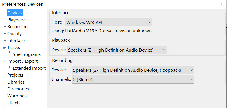

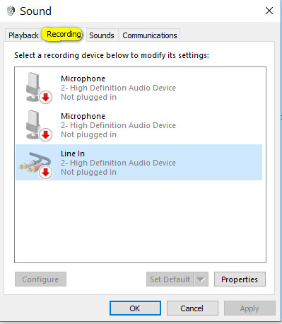

Most of my recordings with Audacity were from the 2 speakers (internal recording), now I want to attach the record player, and in Audacity preferences I was looking for a recording device and it says “No device found”. On the computer’s Device mangr I fond there is a line-in available, but Audacity says “Not found…”.
Attached here 3 screenshots of my question.

Audacity cannot record from non-existent audio devices. As a test, have you tried plugging a TRS 3.5 mm cable into the blue Line-In port? If the Line-In then appears in Windows Sound as connected but it says Disabled, right-click over it and choose “Enable”. Then restart Audacity and you should see the Line-In.
You can’t connect a turntable direct to the computer. Have you got a boom box or music centre or amplifier that has a phono input? If so, plug the cables from the turntable into that phono input then connect the line out or headphones out of the boom box/amplifier to the Line-In. If the turntable is already part of a music centre, do the same - connect the line out or headphones out of the music centre to Line-In.
Then choose the Line-In as Recording Device in Audacity.
Line-in should work, once you plug something in.
