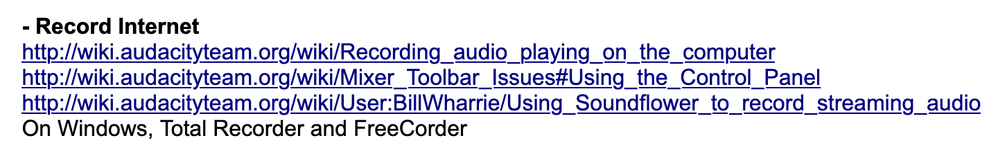

I had them. I had a whole segment devoted to recording the internet…
The Audacity wiki doesn’t exist any more and the content, if it survives at all, is sprayed over the current archive services. I can look through my archives. I usually keep copies of this stuff. That may take a while…
