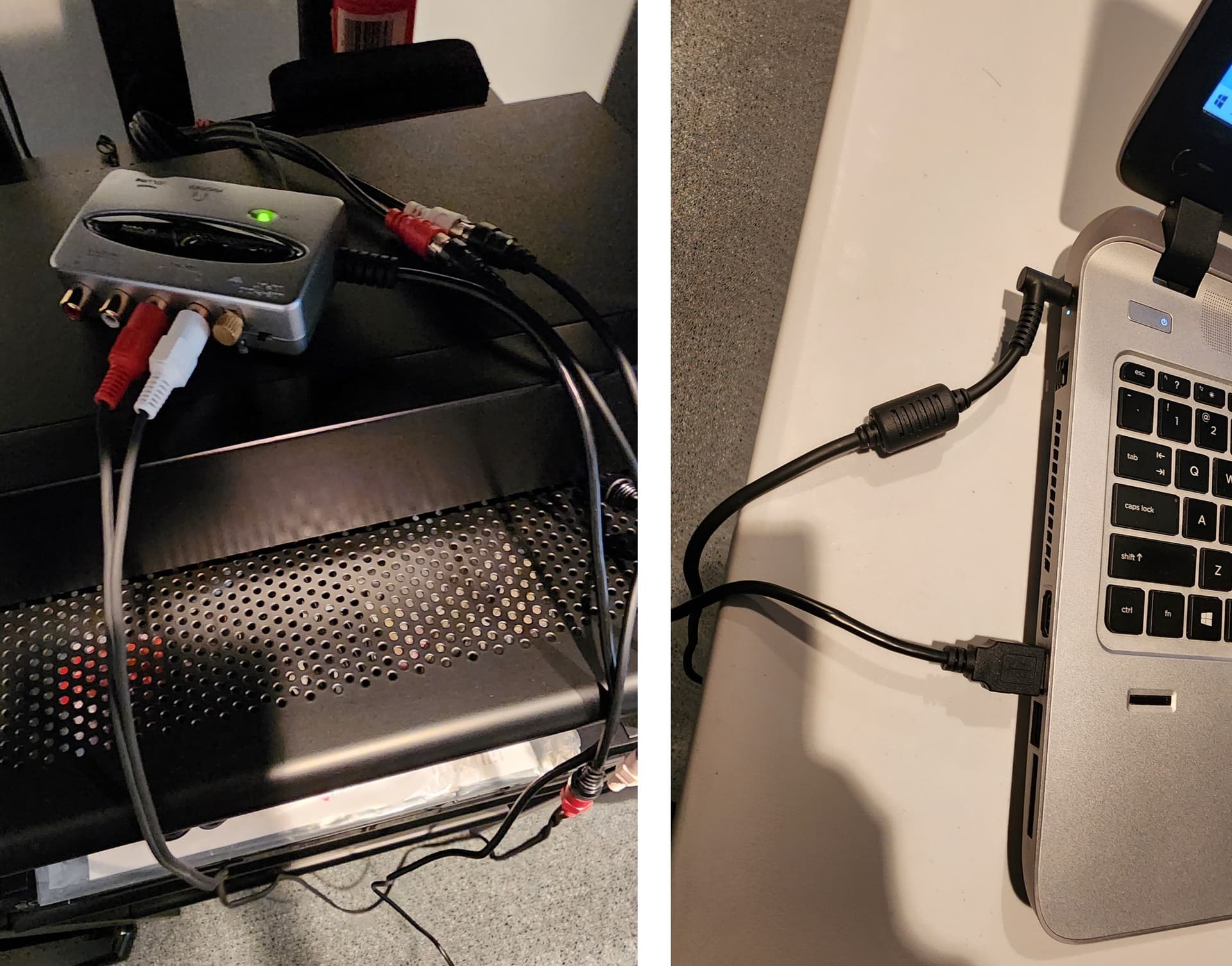

I don’t think I can adjust the analog volume (unless there is some setting under Windows 10 that I am not aware of). I have the outputs of my analog turntable connected to a device called U-Phono UFO202 (see left side of attachment).
From there I connect it to the USB port on my laptop (see right side of attachment).

Do you have a “regular old” turntable without a built-in preamp? …If you have another preamp and the Beringer is switched to “phono” you’d be going through two preamps and it will be way-way too loud and very badly distorted.
If you have a stereo that works with the turntable you can use the “Tape-Out” (or Record Out") with the Behringer switched to “line”. Headphone-out will also work into line-in (with the correct adapter cables) and the headphone output always has a volume control.
