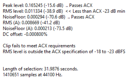

So I am using Audacity to record Audiobooks. I am brand new to all of this although I have done my research and watched a lot of the ACX how-to videos. At the moment I am waiting on my mic and mixer to arrive in the mail but am practicing with just some headphones (I know not good but it is for practice!!) So I can get the hang of roll and punch recording, finding the proper peak volume, noise floor, RMS Level, editing and mastering. I am doing this so that when my gear comes in I am already efficient and don’t make any big mistakes when sending in auditions and audiobooks.
I know that the headphones with a mic are not going to cut it BUT, what does it mean and how can I adjust if I keep getting low RMS (-45 TO -35 range (supposed to be between -23 and -18)) and sometimes I get peaks that are way too high almost 0 or 1 DB (should be hitting -10 but no higher than -3) - the noise floor is not a problem.

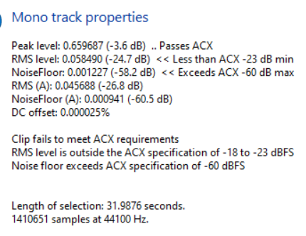

Analyze > ACX-Check :
Noise Reduction (6, 6, 6)
So basically I think its the original recording is not good enough - but what can I do BEFORE mastering to fix this issue. I want to have the best raw recordings as possible and I know this is a common issue even with actual microphones.

This is workable. I applied Audiobook Mastering and moderately stiff noise reduction and the piece will pass ACX Technical standards—just barely.

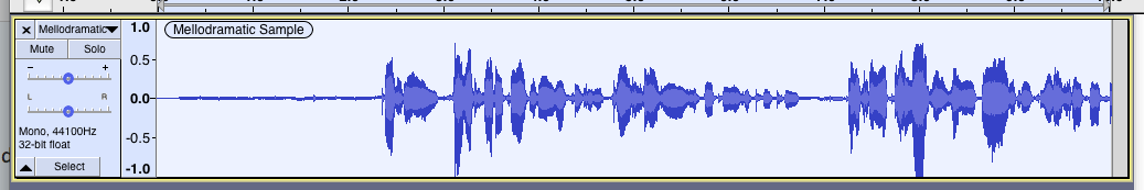

This shows the mastered waves.

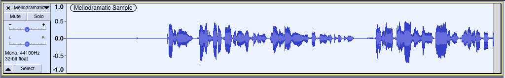

Note the blue line on the left is clean and thin.
This is your original reading. Some of the blue waves are too tall and the line on the left is thick and fuzzy. That fuzz is your background noise.

There shouldn’t be any red marks in your reading. That can indicate serious permanent sound damage. You got lucky in that I can’t hear any damage after mastering.
There is an insane amount of rain-in-the-trees shshshshsshsh noise in the background. I can force this to work, but I should not need high noise reduction to get it to follow audiobook standards.
