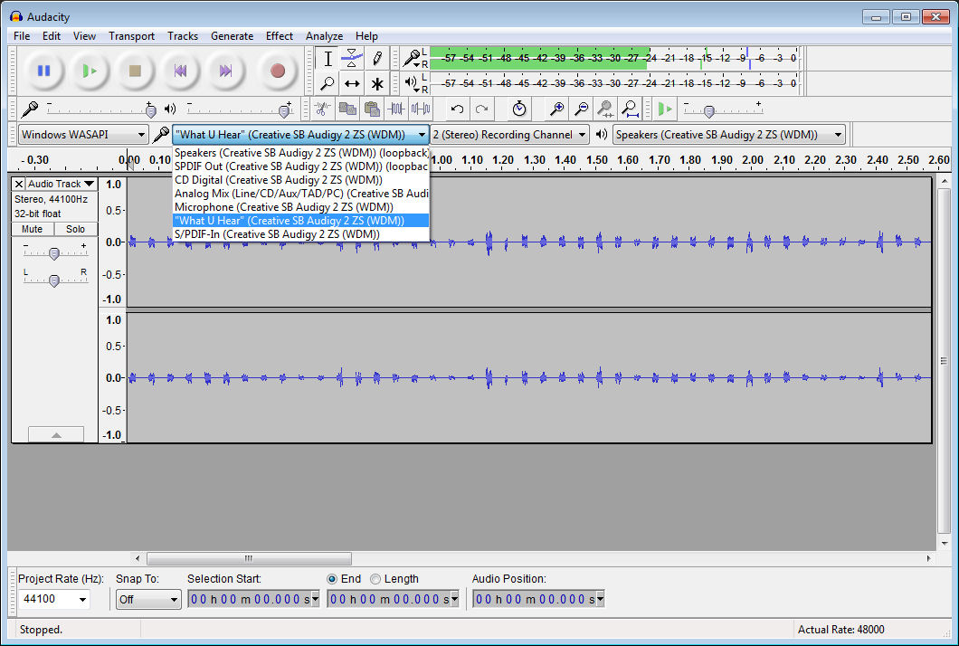

Once in Audigy I have selected MME / “What you hear (Creative SB)” for Audio Device and Recording source. Monitoring seems to be satisfactory, but recording is highly distorted & muted. See screenshot.
Probably not. What-U-Hear is a special, folded-back sound pathway so you can record on-line content, YouTube audio, etc. If you’re just recording a turntable, that will give you multiple sound pathways and the feedback paths will create distortion.
The quick version is to select your sound device directly in Audacity and Recording > Playthrough so you can hear what you’re doing.
You should also make sure your Windows Enhancements are all turned off. Windows naturally assumes you want to Skype to your company offices and automatically applies noise reduction and other processing. As a rule, the processing hates music.
Select “line Input” (presumably where you’re plugged-in) and that will give you the direct connection Koz is talking about.
And, try WASAPI instead of MME as your audio host. WASAPI is the newest Windows protocol (2007 ?). MME is the oldest (1991 ?), and DirectSound is in-between (1995 ?). Sometimes one or more of these won’t work with your soundcard, but I’d try WASAPI first, then DirectSound, and finally MME if neither of those work.

  2. There is no selection for “line-input”. The available selections are shown on the attached screen shot. I tried Analog Mix - same result. I did try re-scanning, but nothing new showed up.

I did try ‘piggybacking’ off the successful recording by opening it and initiating a recording of a second track. On the first attempt the recording was good… it did not show the distortion and low recording level. However, on all subsequent attempts the distortion reappeared. Actually, I don’t think distortion is the most accurate term. It looks like the audio signal is suppressed at regular intervals. You can see this in the screenshot.

Are you trying to sing along to the vinyl and record your voice as well as the vinyl, or something else you have not explained? Otherwise, if you only want a clean recording of the vinyl, do not choose What U Hear because it is ONLY meant for recording computer playback.
How exactly are you connecting the turntable to the SoundBlaster - do you go through a phono pre-amp or is the turntable part of a stereo music centre? And then to what input exactly of SoundBlaster are you connected? If you are connected to the analogue stereo input, “Analog Mix” should be the correct recording device. If you connected to the optical input, S/PDIF-In is the correct recording device.
Have a look in Audacity at Edit > Preferences > Recording… section. Make sure “Audio to buffer” is set to at least 100. You can try increasing it to 200. If that is not the problem then you may have to go into Windows Sound, Recording tab. In the SoundBlaster Properties for the input you are connected to (see above), try setting Default Format to 44100 Hz.
