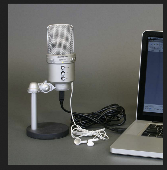

Thanks a bunch for the response. It is a USB mic so you are suggesting I move the knob from MIC to COM so as to have the recording focus away from the MIC audio.
That and standing further away, does that sound right?

Which one? The more information you tell us, like part and model numbers, the more solutions we can offer.
I think the short answer if you are trying to do a pro job with a home microphone. When your voice gets converted to electricity, there’s not a lot of it. The conversion usually gives a sound signal roughly a thousand times quieter than it needs to be for production. I’m not making that up.
So there’s always a booster somewhere. In the case of USB microphones, it’s built-in. That’s what you’re changing if your microphone has a volume control on the front.
If you scream into the microphone, you may not need the booster any more, but you can’t get rid of it—and it doesn’t like being overloaded.
Your only options are reduce the performance volume or change the microphone.

Haha that info about the rock bands and heavy metal bands is epic. Yes here is more context on the setup: audio technica at2020 usb with Audacity.
Most times the voice acting role won’t require a full screaming session but rather spurts. And then sometimes there’s the pure military screaming gig so it’s good to plan and know what I can and can’t say yes to currently given my set up.
I know that there are better mics out there but this one had solid reviews and until I’ve earned my stripes I want to maximize this set up.

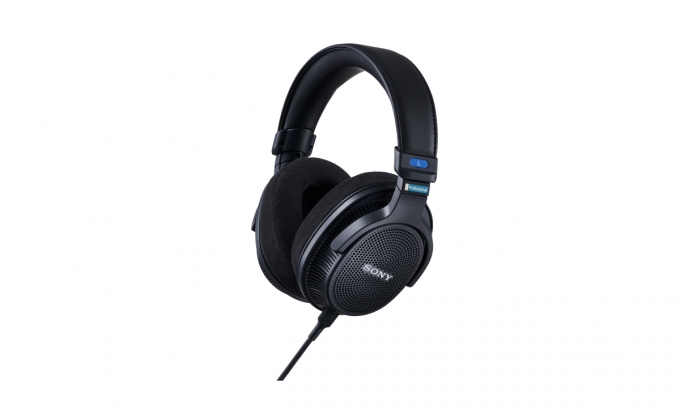

You can tune this effect by wearing the live headphones. That’s why they’re there. The AT2020 has provision for headphones. About five minutes rehearsal should give you the best performance technique for the show.
Fair warning the headphones need to be large, cover-the-ear types to prevent the headphone sound from escaping and leaking into the microphone.
I think you can still get the Behringer HPS3000 headphones. They’re OK for production, but not casual or movie listening. I like my Sennheiser eh150 headphones, but they’re not made any more.
We were moving an edit room between wings of the building and I saw the Sennheisers in the trash. I took them home and fixed the broken wire and they’ve been here ever since. I bought a second set while I still could.
To bring this around, the Hollywood movie people use the Sony MDR-7506.
If you ask the sound people for headphones on a set, that’s what they are going to hand you.
