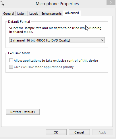

I’m starting to wonder if it was caused by one of the few Windows updates that just randomly popped up a couple months ago. But if this were to be the case, I honestly have no clue how to even reverse this problem. I tried unchecking some boxes under the “Advanced” tab for the microphone, but still nothing. I’m actually just considering getting a new mic at this point, but hopefully one of you guys can help steer me in the right direction to correct this issue.

Make sure Windows “enhancements” are turned OFF..
“Enhancements” tab can be next to the “Advanced” tab
enhance
Windows update can enable “audio enhancements”.
It’s just a matter of unchecking any ticked boxes in the enhancements tab.
Yeah, so mine does not have an “Enhancements” tab
There can be other layers of similar “audio enhancement”, they include “MaxxAudio” & “DTS”.
