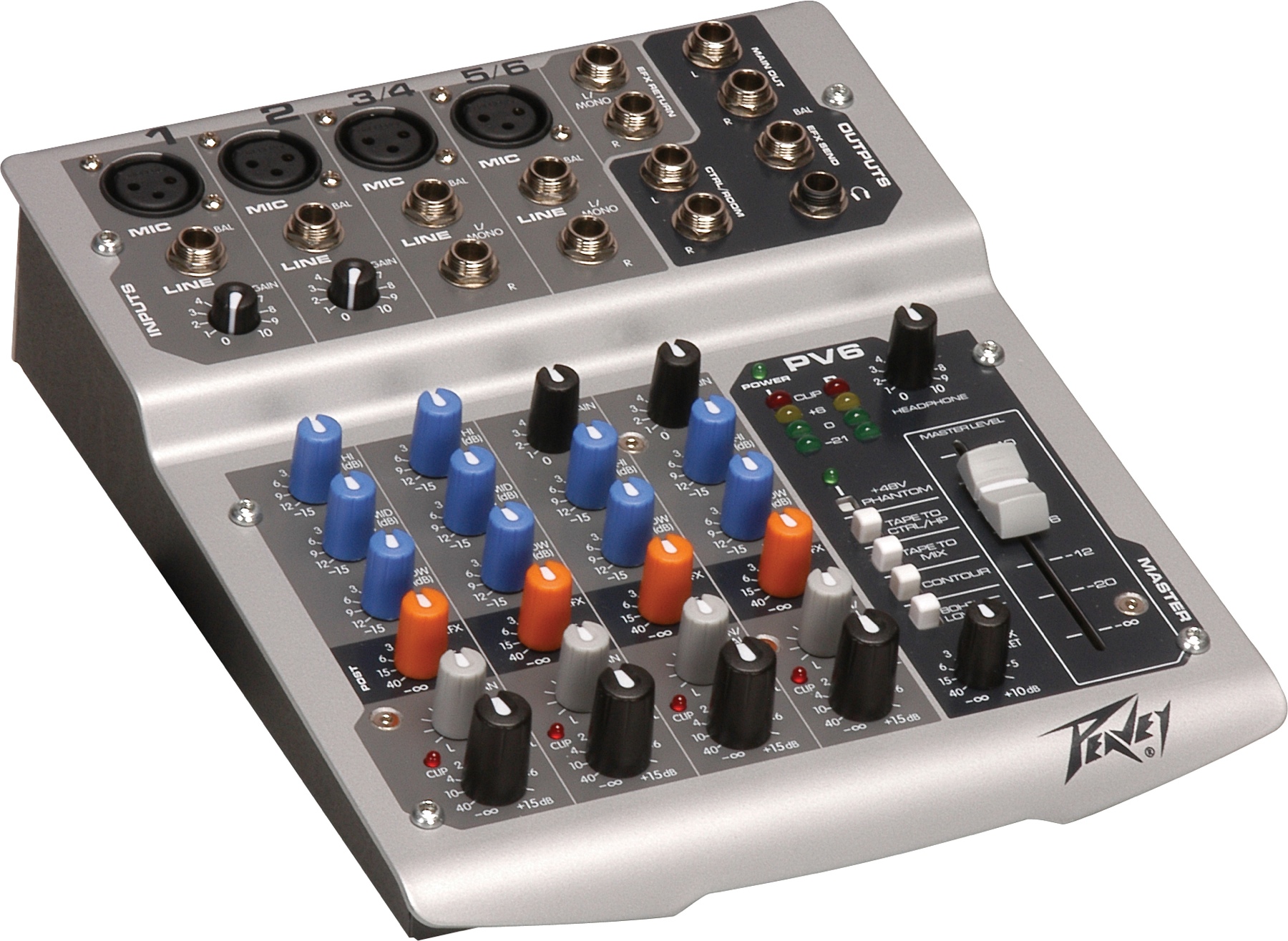

That happens in post production. Do you get any red overload lights on the sound mixer? That’s not unusual, either. A good, robust microphone can generate enough signal to beat the pants off the microphone amplifier in the mixer. The larger mixers have a “trimmer” control to deal with that.
http://www.sweetwater.com/images/items/1800/PV6-xlarge.jpg
Click the graphic. See the little knob way on top labeled “Gain.” Adjust until the red lights go away.
