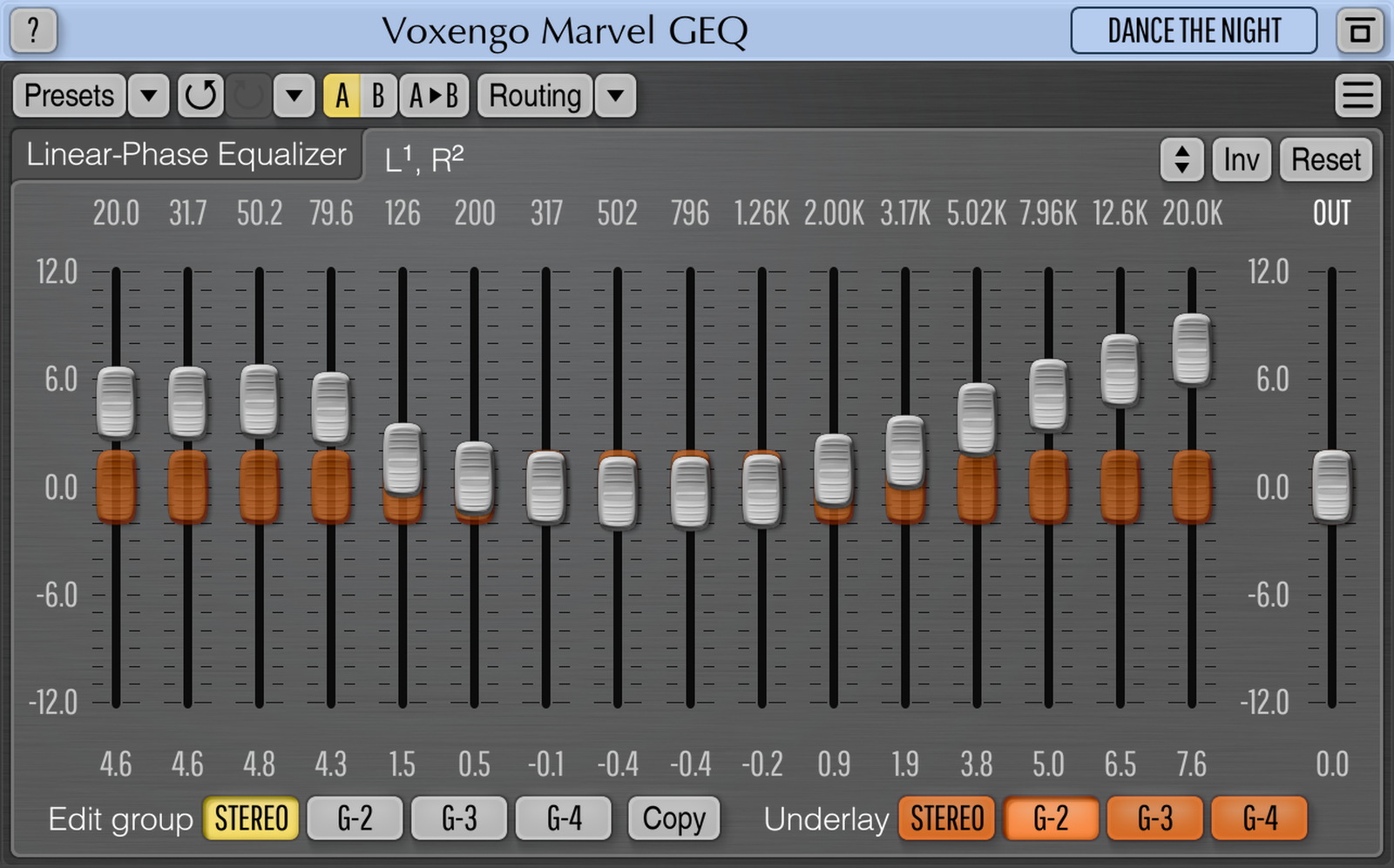

Experiment with a real-time equalizer plugin, e.g. …
http://www.voxengo.com/product/marvelgeq/ (fully functional freebie & no strings attached)

I can’t get this plugin to work. I downloaded it and in install setup I put the file in the program files of audacity/plugins. Then in audacity under add/remove plugins I found it an hit enable but I can’t pull it up anywhere. What am I missing?
