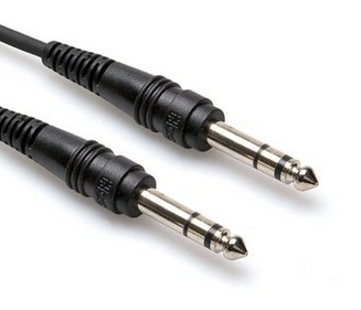

Did you connect the system with a stereo 1/4" cable? Does the plug have two black bands or only one (attached-2)?
So it’s stereo (tip=left, ring=right, sleeve is ground) inside the 2i4. Now it gets fuzzy. What does the 2i4 do with the right channel if you unplug the XLR?

You can do some experiments. Plug a stereo 1/4" cable (two black bands) in the left input and nothing at all in the right. Set both for Instrument. Hold the other end of the cable with a towel so your hand doesn’t touch the connector. Get something all metal like a paper clip or fork and touch first the tip of the connector and then the ring between the two black bands. This is a quick and dirty way to see if there is signal down the cable. If you start recording in Audacity, it should buzz certainly when you touch the tip, but might also buzz on the other side if you touch the ring.

Thank you for the reply. It is a stereo 1/4" that I’m using also the mic is a Rode NT1-A. Incidentally the keyboard is a Yamaha NP-30 and, your right, i’m just using the headphone output.
I tried that little experiment multiple ways and the 2i4 consistently responded to both the tip and the ring of the jack being touched. However the response was outputted to a single channel, as you might suspect. It recorded to a single channel in audacity and panning my speakers left and right didn’t isolate the buzz from either part of the jack (my 2i4 runs into a separate amplifier that has a left/rial dial). I suppose that narrows the culprit down to the 2i4. Presumably it ‘mono-tises’ the stereo input. I’ve always thought that the 2i4 wasn’t capable of outputting in stereo it’s only that I was so convinced that audacity had somehow captured stereo audio from the keyboard. Obviously I was too elated to bother saving the file as evidence.

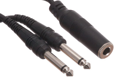

Assuming I am crazy and mistaken about the recording, and assuming the 2i4 does reduce all signals down to a mono output, perhaps something like the adapter pictured below would work. Presumably it separates the signal into a left and right output and I could simply plug both into the 2i4. It wouldn’t leave any room for a mic but I could live with that.

I don’t think that cable is going to work. I think it’s just a simple “Y” cable. Put one mono show into two places. The product description has to say “Stereo Splitter” and the plugs should be marked somehow Left and Right.
Yes I think some sort of splitter cable would be the best option. I rarely have a need to record vocals and piano simultaneously anyway so it’s a minor grievance. In the instances that I do I’ll try adding some stereo effects in post as Trebor kindly suggested.
