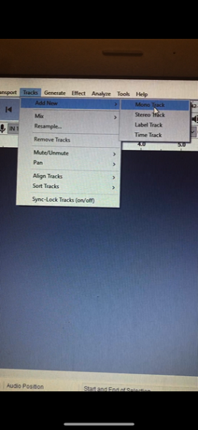

I’ve tried that to no avail.

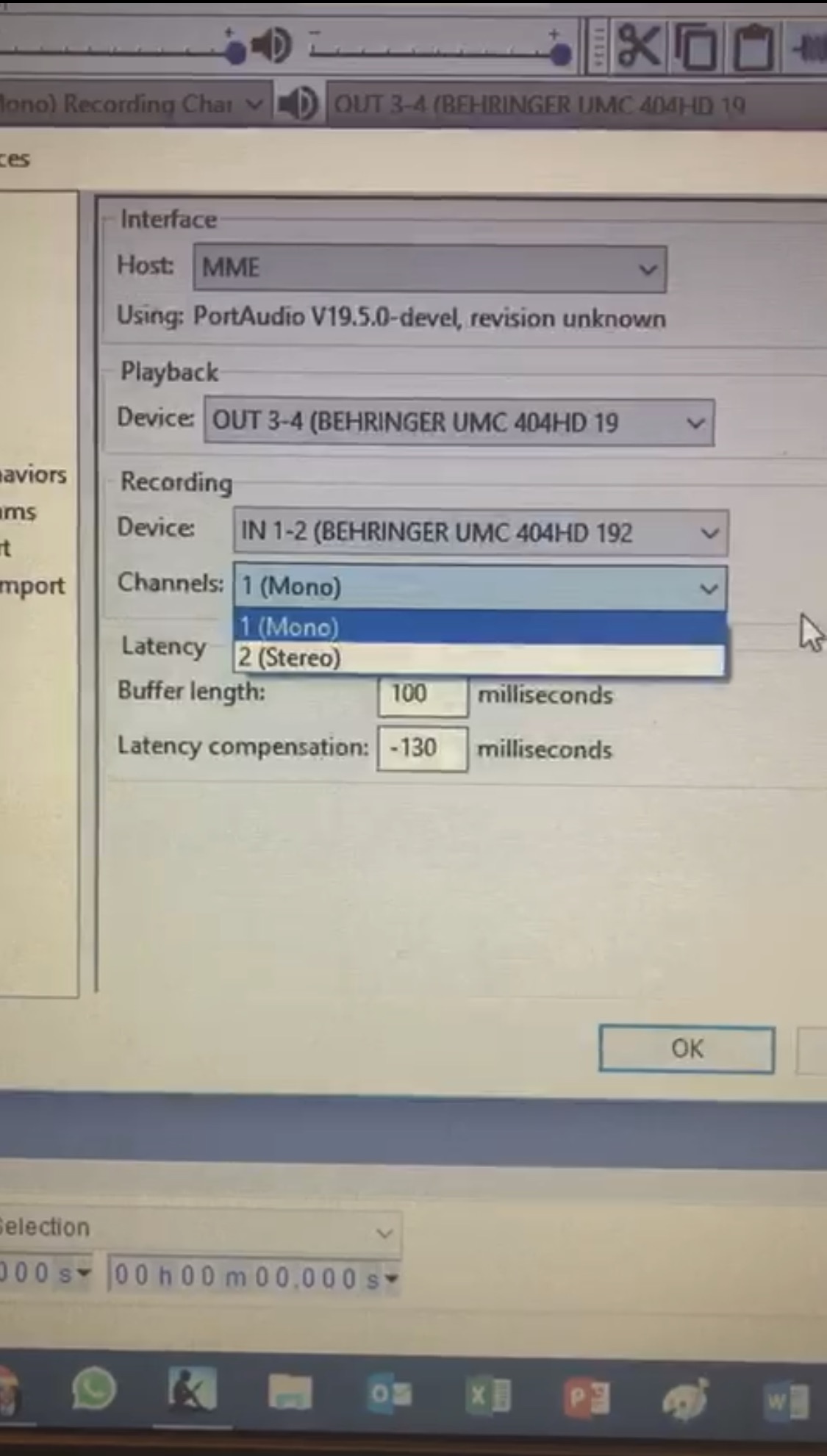

Is there an option to set the number of channels to 3 in the device toolbar?
Note that for recording 3 channels on a 4 channel interface, you should use input channels 1, 2 and 3.

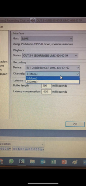

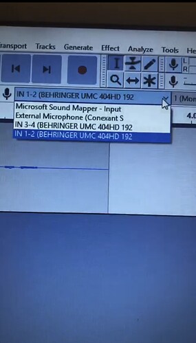

I can only record audio from Mic 1 and 2 simultaneously . However, Mic 3 I have to toggle the Recording device into Mic 3-4
Please see attachment
Try the other two “host” options in the device toolbar (Direct Sound and WASAPI) and see if either of those offer more than 2 channels.

and thanks for replying so fast. Nope there’s only two channels with WASAPI or Windows DirecctSound

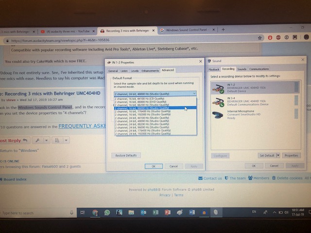

Look in the Windows Sounds Control Panel, and in the recording tab, open the “Properties” for the UMC404HD.
Can you set the device properties to “4 channels”?
I just tried doing it and it I couldn’t find 4 channels. See attachment
That’s unfortunate. The Windows device drivers are split into two stereo devices, one “device” for channels 1 and 2, and another for channels 3 and 4.
Audacity is only able to record from one device at a time, so that gives you the option of recording from either the “In 1-2” device OR from the “In 3-4” device.
Unlike macOS and Linux, Windows has no built in way to “aggregate” the two devices as a single device. The only way to do that on Windows is to use 3rd party software, such as Virtual Audio Cable (VAC) or Voicemeeter, which is a bit complicated. I’ve not used it myself, but I suspect that “VB-Audio VoiceMeeter” is probably your best bet.
