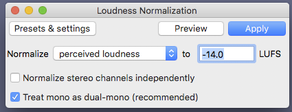

It does, but not the way you (or most people) want. Audacity will record a single microphone as “Left” in a stereo pair. This is the process with the least damage to the sound. Record in Stereo, convert to Two-Channel Mono and delete the blank track.
Audacity will actually record in mono, but it leaves room for a stereo to mono conversion by dividing the sound by two. You get a single track, but it’s half the volume and twice the noise.
