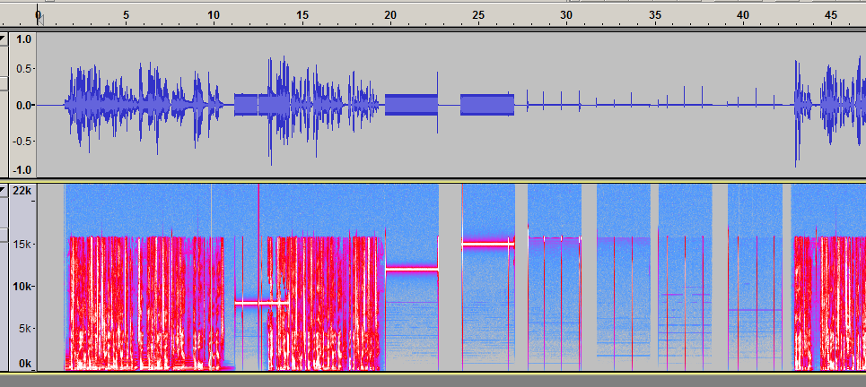

So I need to prove that this sound actually exists. I was thinking that I could record it and boost the volume, so that’s what I tried. I connected a male-to-male jack from the output to the input and recorded the sound with Audacity. I successfully captured the sound, however there’s a lot of static noise when I turn up the volume, which masks the sound. The static isn’t present/audible normally.
I tried the frequency analysis to visually prove the sound’s existence, and there are spikes at around 7 kHz and 14 kHz. I used the notch filter to remove these frequencies, and sure enough the sound disappeared. However I’m not sure the results are conclusive, because my other computer also have spikes at 7 and 14 kHz, but that one has no high pitched sound.
I also tried to isolate the sound by using the notch filter (removing all but the 7 and 14 kHz frequencies), but it seems like when I remove the frequencies next to 7 and 14 kHz, these frequencies weaken as well.
These are the results of my experiments:

Screenshots:
http://imgur.com/a/lxQhF
The first six pictures are previous recordings for which I have no corresponding sound clips. The next 4+4 pictures match sound clips 1 and 2 respectively. Unlike the first six recordings, these are boosted beyond just turning the volume up in Audacity (which is why they’re so fat). I don’t really know how it happened, it wasn’t intentional, but it occured when I exported and saved the files and then dragged them back to Audacity.
So is there a way to record the high frequency sound without static noise? Is there a way to isolate the sound / remove the static noise? Is there a way to visualize the sound in a conclusive way?
