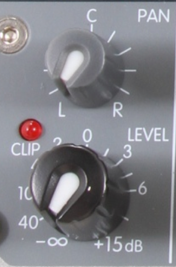

This is a closeup of my mixer. The “Pan” control lets me push the microphone anywhere from far left in your headphones (the illustration) through center to far right.
That’s the knob you would need to do this voice on one side and analysis on the other business.

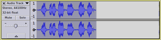

When you record a stereo track into Audacity, channel 1 should be recorded onto the upper channel and channel 2 onto the lower channel of the stereo pair.

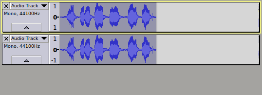

A stereo track looks like this:
After the track is split it should look like this:
