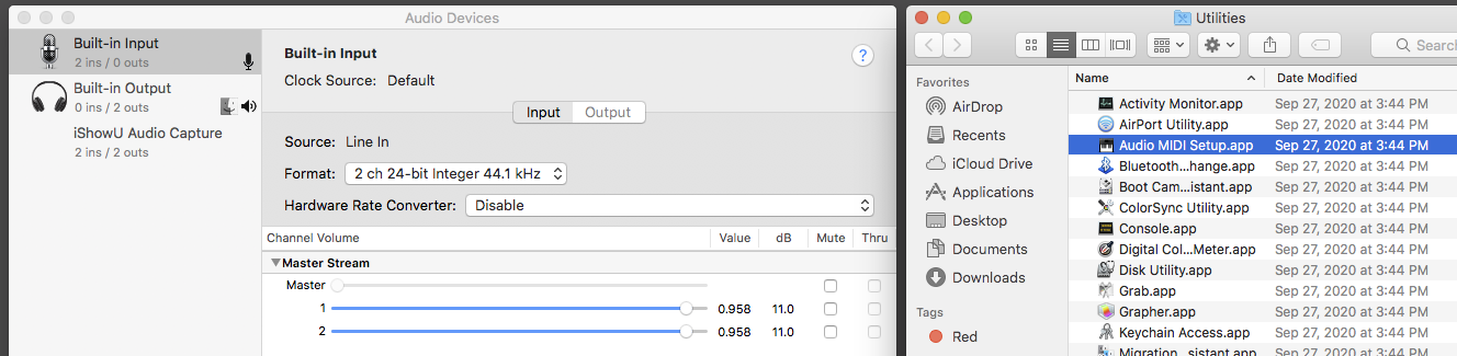

You might be able to do it by creating an “aggregate” device in Audio MIDI Setup (look in your Utilities folder). I have no experience doing this so I don’t know if it is even possible.
