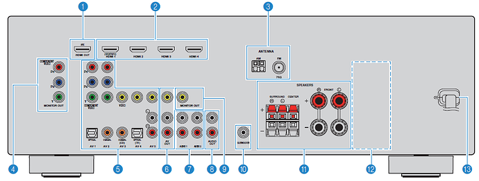

Or, I do have an audio out on my receiver, appears to be just stereo (red and black RCA type plugs), reconnect to green (and blue?) plugins on my sound card? Am I on some kind of track here, or completely off? The signal on audio out of my receiver would be digital, so I’m thinking the multiple conversion problem may come into play. Ugh, I’m so frustrated.

Yes, either revert back to the analog setup you had before and record from “Stereo Mix”,
or if you have analog stereo output from your receiver (you mentioned two RCA connectors and that makes me think it’s analog),
connect them to the computer’s blue line input and record from “Line In”.

I had a look at the manual.
(8) are stereo analog outputs. Connect them to computer’s blue line in using this:
Ragnar
Awesome!, in the intrim I hooked back up my old logitechs and reverted backwards from the digital out/in to my receiver. I was concerned I wouldn’t have heard back from you guys in time for the 12/12/12 concert. So I’ll get the cable and hook up as you’ve instructed, any issues with “multiple conversions”? (not sure what that means) thats been mentioned in some responses? My realteks outputs are all HD audio, so I’m assuming the audio out setup you’re reccomending will pass the digital signal back thru the cards audio in and should be good to go. Now I’ve got 10 speakers set up, the logitechs and my Yamaha, and 2 subs, a little cramped in my 12X12 office, I’ll be happy if the Yamaha out, to realtek works.

I gather you are recording an audio stream from the net. That stream has a certain sample rate and bit depth. Your computer quite possibly resamples to some other rate/bit depth before sending it out its digital output. That’s one conversion (digital → digital). The Yamaha converts the digital signal to analog and sends that out its analog outputs and to the speakers. That’s conversion number two (digital → analog). The analog signal from the Yamaha arrives at the computer’s line input and is digitized by the Realtek chip. That’s conversion number three (analog → digital).
Each conversion may introduce problems in the form of noise, clipping, gain differences and distortion. Or it may not. You’ll have to try it out.
No, as said above, the Audio Out from the Yamaha is analog, as is the Realtek’s blue Line In. HD Audio does not necessarily mean that the entire chain is digital.

Thanks for the reply! You certainly know your stuff! So theres no way to minimize the “conversions”? Even if/when (way too many speakers in my office) I go back to soundcard digital out to Yamaha digital in? Yamaha is receiving digital in, signal goes Yamaha audio out, to realtek soundcard in. Is, or would this still be 3 conversions?

Yes, it will still be three conversions. There’s no way to avoid it with that setup. That said, I really don’t think you’ll run into any major problems. I’ve used a setup much like that myself (I even have the exact same Realtek chip as you do) and when recording from the net, the weakest link in the chain has always been the source material, not my equipment.
