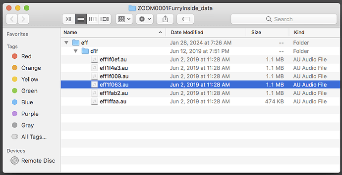

The old project format has small AUP file, and a bunch of little AU files, in a folder with the same name. Sometimes the AUP file was copied or backed-up somewhere and then you’d have an incomplete project.

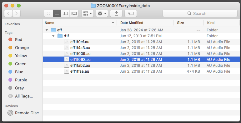

Below is a complete Project.
The two have to have the same name and they have to be in the same location or folder. No option. The AUP file tells Audacity how to construct the show from all those little 6-second sound files. Yes, they are intentionally randomly named.

This is an illustration of a Project.
I can open and play each little .au file. Can you play yours?

They are six seconds each and were intentionally designed so the filenames make no sense. You would think this would be insane, but I’m recalling this was done to stop run-away file damage under some conditions.
I can tell you that in a stereo (two channel) show, the little .au files alternate Left-Right-Left-Right.
If you have a way to reveal each file time and date, that does work, although it might take you the rest of your life to construct one Project.

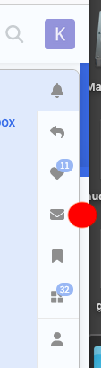

Yes, I wish more people realised this. Are you sure newcomers can send personal messages? Some people I’ve helped say there is no blue ‘Message’ button. There was a thread where Steve explained it was an anti-spam measure.
Mark
No. The old forum had a provision where moderators could send emails. Not any more.

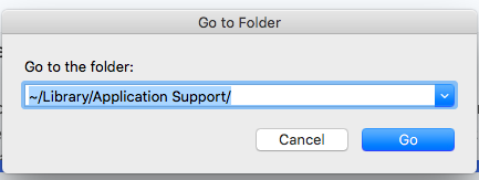

That’s a single hidden folder on a Mac.
Delete the “audacity” folder.
